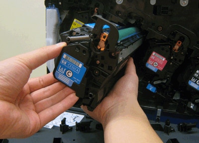

Figure 4: Pull the cyan print cartridge out
example
4. With one hand, slowly continue to pull the cyan print cartridge out of the printer, while supporting the cyan print cartridge with your other hand. Then put it on a clean level surface.
CAUTION: Do not touch the green roller on top of the cartridge. Doing so can damage the cartridge.
